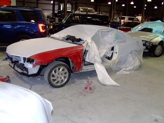

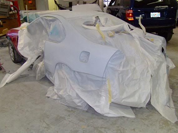

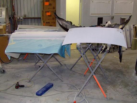

ok so i went to the shop 2 days ago and got some updated pics and i rolled the front fenders.
so the roof and quarter panels have been primed and block...
antenna has been shaved
trunk, doors, and rear bumper have been final blocked.
rolled the fenders.
they had marked where the side marker goes but i elected to have them shave the side marker from my jdm fender. i figure it will look a lot cleaner without the side markers.

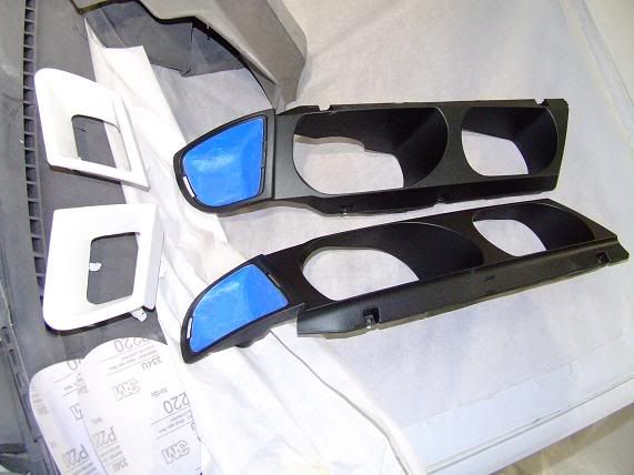

so i took out the housings of my spare black housing headlights and taped off the part for the parking light. i am having the housings painted the same color as the car (glacier frost mica). ive never seen this done on a prelude so i figured i would try it. if i dont like it i have my other set of black housings so not to worry. i am currently wetsanding and buffing the lenses and i am finishing up the retro fit. ill post pics of the progress later.

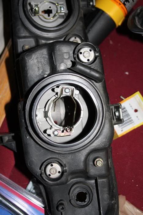

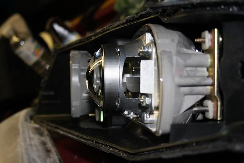

here is an update on the retro fit. while the inside covers are in the paint booth i am getting the rest of the headlight ready for assembly as soon as i get them back painted.
i have finished putting together the mounts for the projectors. i mounted them to the reflector dish and reinstalled them in the housing to the oem points to retain the beam adjustability.
these projectors fit perfectly inside the dish with very little modification allowing me to retain all the oem qualities of the outside of the headlight. the only thing done to the original parts of the headlight are the 4 holes drilled in the back of the dish in order to mount the projectors.
as you can see... the back of the headlight looks exactly like it did when i got it. when you look where the headlight bulb clips in you can see that the reflector dish to the projector is almost flush with the opening of the original reflector dish that the headlight came with. this should allow the bulb to go in just as if this came factory.
