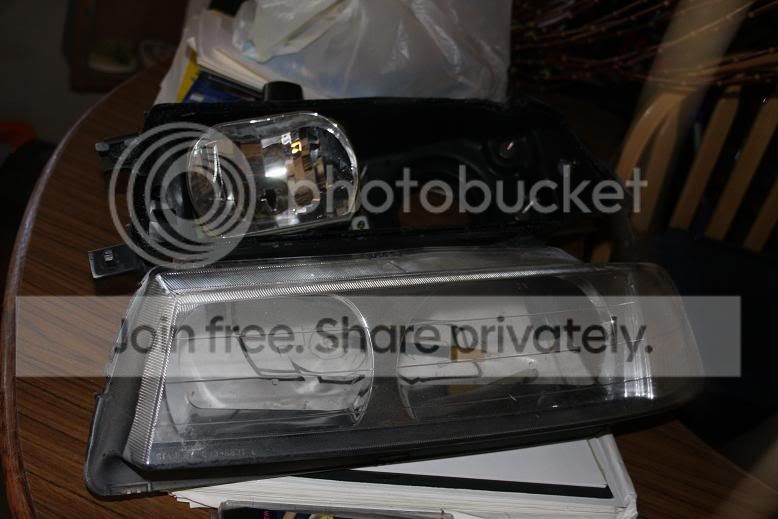

so to keep this thread alive a little i have been working on my retrofit a little bit. i am doing all of this to a spare jdm one piece headlight i have since its my first time... just in case i fuck up.

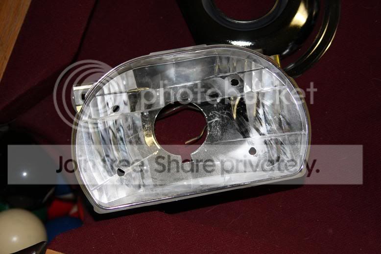

so i go tthe headlight all apart and i took out the low beam reflector bowl so i can mount the projector to it which will allow me to use the oem adjusters to adjust the beam once its all together.
here is the reflector bowl... i drilled out 4 holes i measures to mount the projector to it.

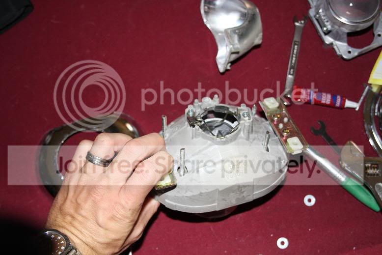

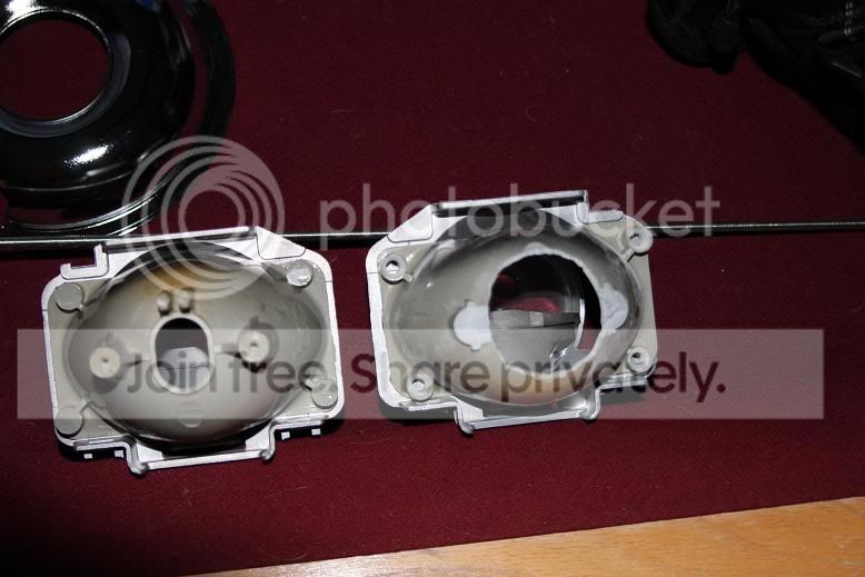

here is a before and after of the back of the projectors. i cut out the packs to allow the bulb to fit with no problem. i trimmed off the stock mounting points for clearance issues. and then i drilled out 4 holes where the 2 halves of the projector meet. i got a long threaded pole from home depot to use to mount them to the reflector bowls.

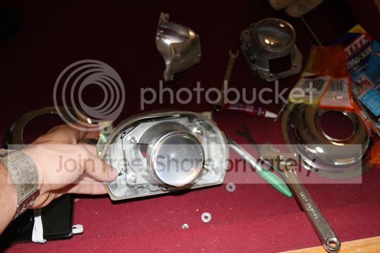

so i cut the threaded pole and used some washers, nuts and thread lock to hold the 2 halves of the projector together. i was then able to push the projector into place with the cut threaded poles going through the holes i previously cut in the reflector bowl in order to use locking nuts from the back of the bowl to hold the projector in place.

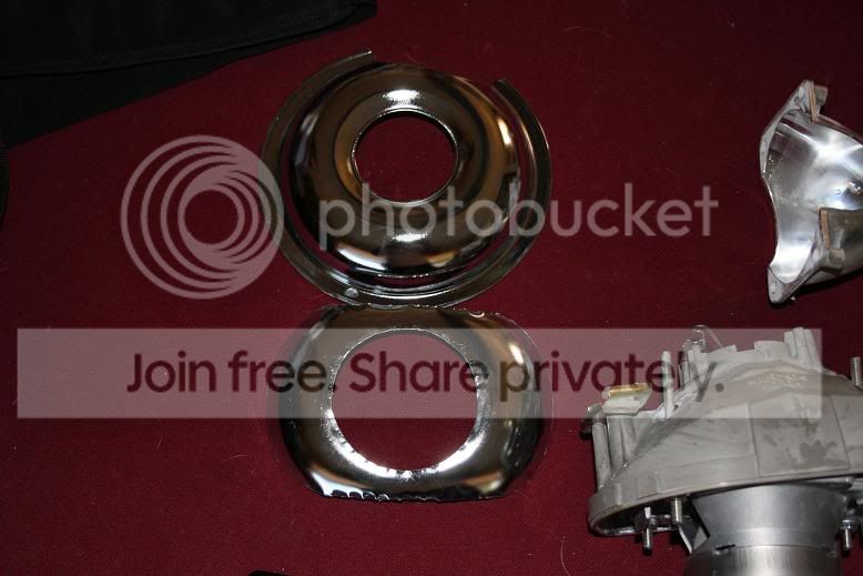

here is a practice cut for a home made shroud made from a stove top drop bowl. a flange of sorts will be used on top of this to clean it up a little bit. i got this idea from lilboi on bayareaprelude.com
