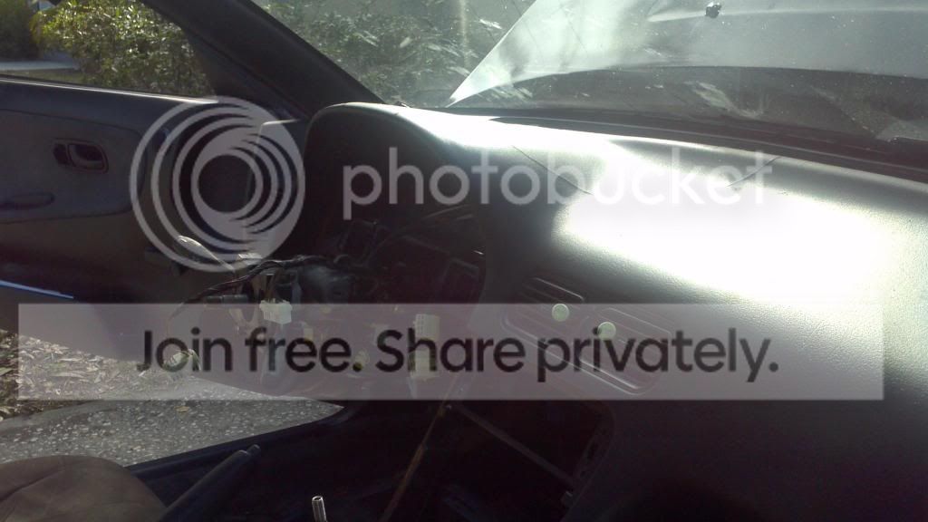

Dash Pulling progress...
Pulling the brown dash out of the "new" shell for disposal....
The black dahs on its way out for repairs from the "old" hatch...
As the blue daily sits now..."wrapped up" until I get the dash cracks address for installation int othe new shell...
More to come as I set off to repair those typical cracks.
-Royce
