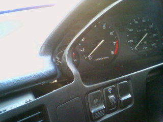

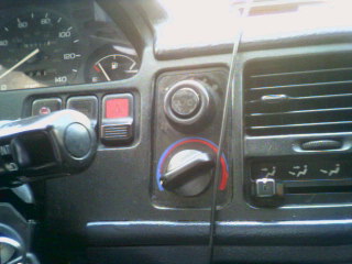

DA92driver's Avatar
Joined: Aug 2004
Posts: 944
ok, ran into a slight lil problem, i figured i would see what experiences had to bring to the table befor i broke somethin, the dash that you have to remove to get to the cluster.now i got the left side off no problem, 4 screws and a lil prying, but the side that the a/c switches are and midlle is a doffrent story, i cant get around or behind to see if anything is holding it in, and if i lift the side i got off it will brake the pice in 1/2, and prying does no good because its the border of the ac switches and is vety thin and frail. any suggestions?
