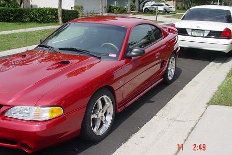

i am replacing my stock fuel pump from my 96 ford cobra. i wanted to know if this will severly effect my gas mileage even with normal driving and if a 255lph is to big?if so what should i throw on it?

thats clean for a 96..
