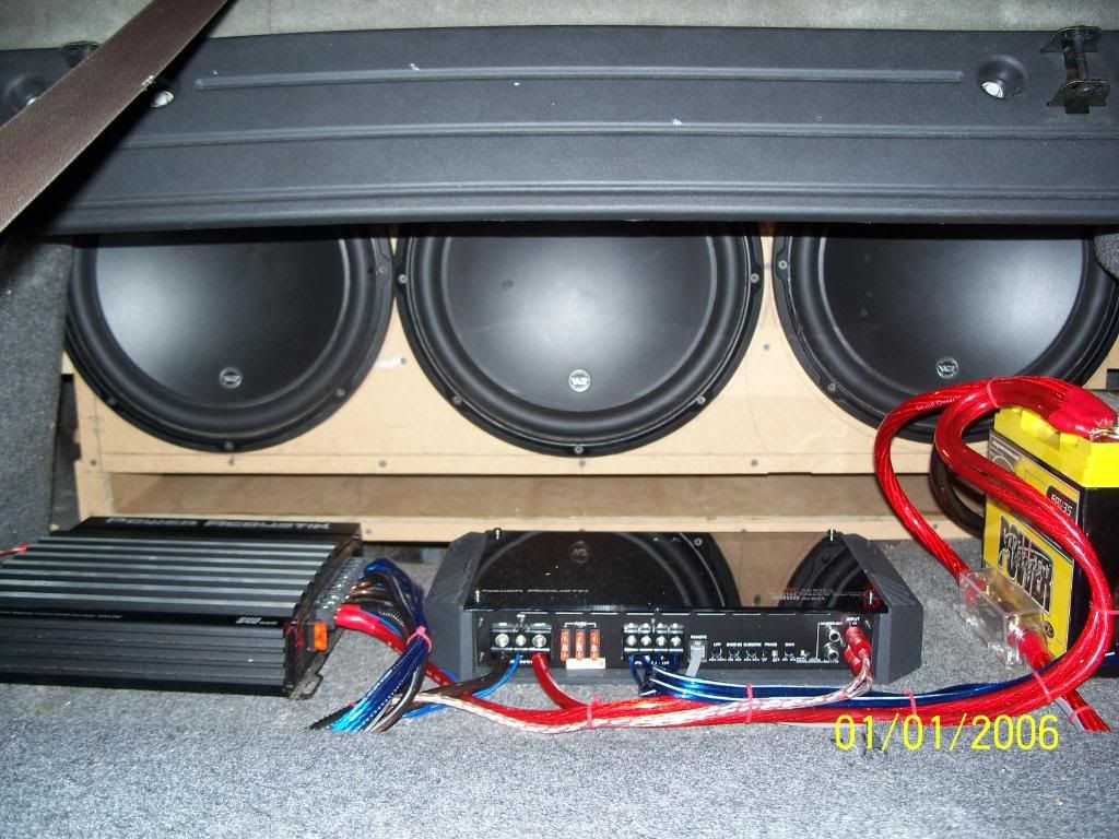

2001 Chevy Impala

minus the raw box i like it..

Sub over lap FTL!

What about when the passenger airbag deploys???
And I don't see anything attaching the battery, which is a pretty severe safety hazard. Wiring is pretty neat and clean around the amps though, nice job there.

personally i would have sealed the trunk off and ported it thru the rear deck, it would be louder and sound better. and i agree how is the battery held down?

The vehicle was in an accident and the airbags deployed. He did not replace the passenger side airbag so he could have the 10" TV.
The machine shop next door fabricated a bracket that holds the back "hand hole" of the battery, as well as the metal sleeve being attached to the amp rack. (just trying to keep it clean) I don't think it's going anywhere.

All the guy listens to is rap and slowed down rap. The box is tuned all the way down to 20 hz. The doors all "flap" and the front window flexes 1/2" both ways. (slowed rap only) It won't play jazz, or anything but rap, but that's what the customer was looking for.
This customer was looking for something that no one else has.
