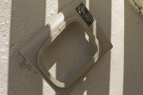

took out the airbag to put in an upper glove box
heres the start of texture
