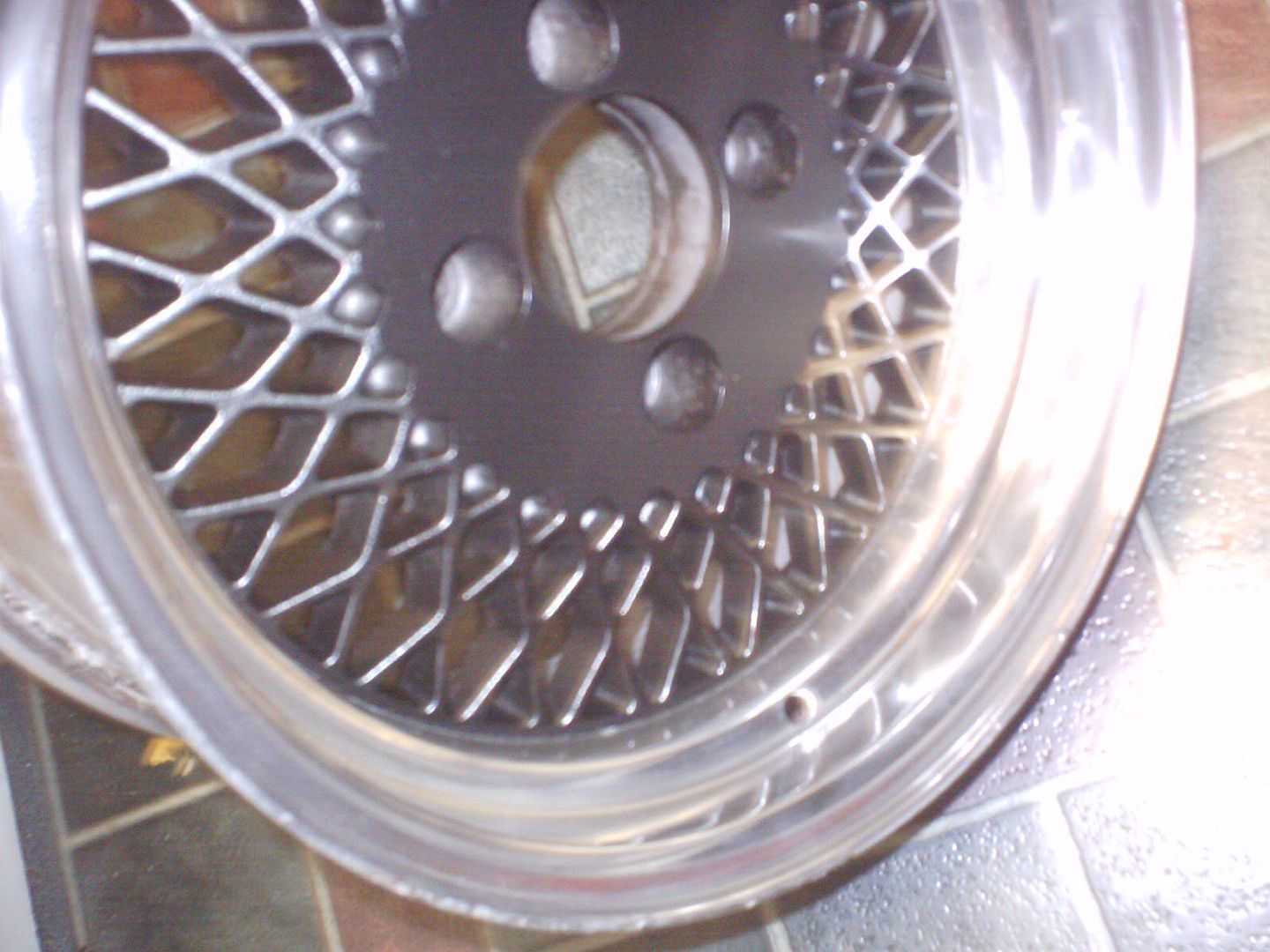

i have a 82 5m tb. dont have the afm though. the wheels. 2 of them have lile marks like someone smacked them with a pick hammer or something. havent polished all 4 yet, just 2 and repainted the centers gunmetal. i can make all 4 look like this if you want. itll be a lil more then what id take for them as is of coarse. lol. tons of sanding involved before they can be polished like this.
heres more pics
