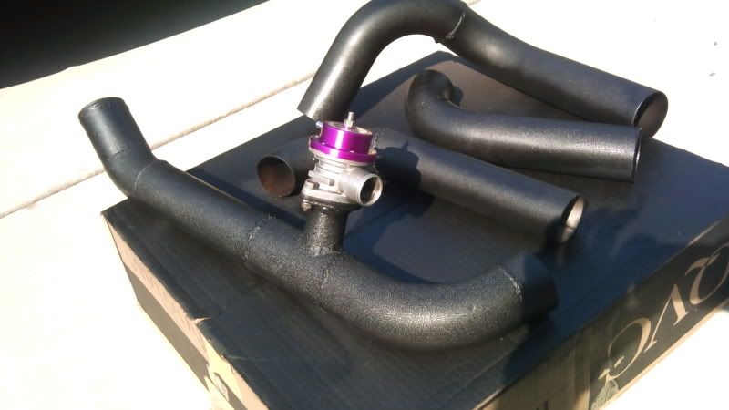

Just a few of what i plan on doing within the month, Still need to assemble motor and do the misc. stuff under the hood such as radiator, starter, etc...here a few pics, dont have much yet but will update as the build goes on.
power goals? Hopefully on dyno day i put down around 300whp, with the stock head i will probably max out aroudn 18-20 psi, later plan on building the head as i go for more towards 400whp. Yes its a single jingle and its gonnnaaa ride
Negative comments to yourself / to each their own. I will update as i go, thanks for looking
When i first got her home, i have the side molding and all to put on just havent touched much
Went a little crazy on the VC's
Turbo pistons, paineted the piping, Turbo
