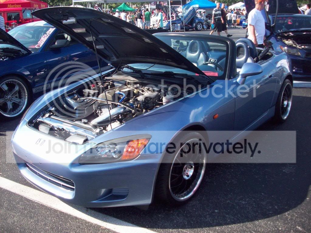

At Hot Import Nights St. Pete 2009:

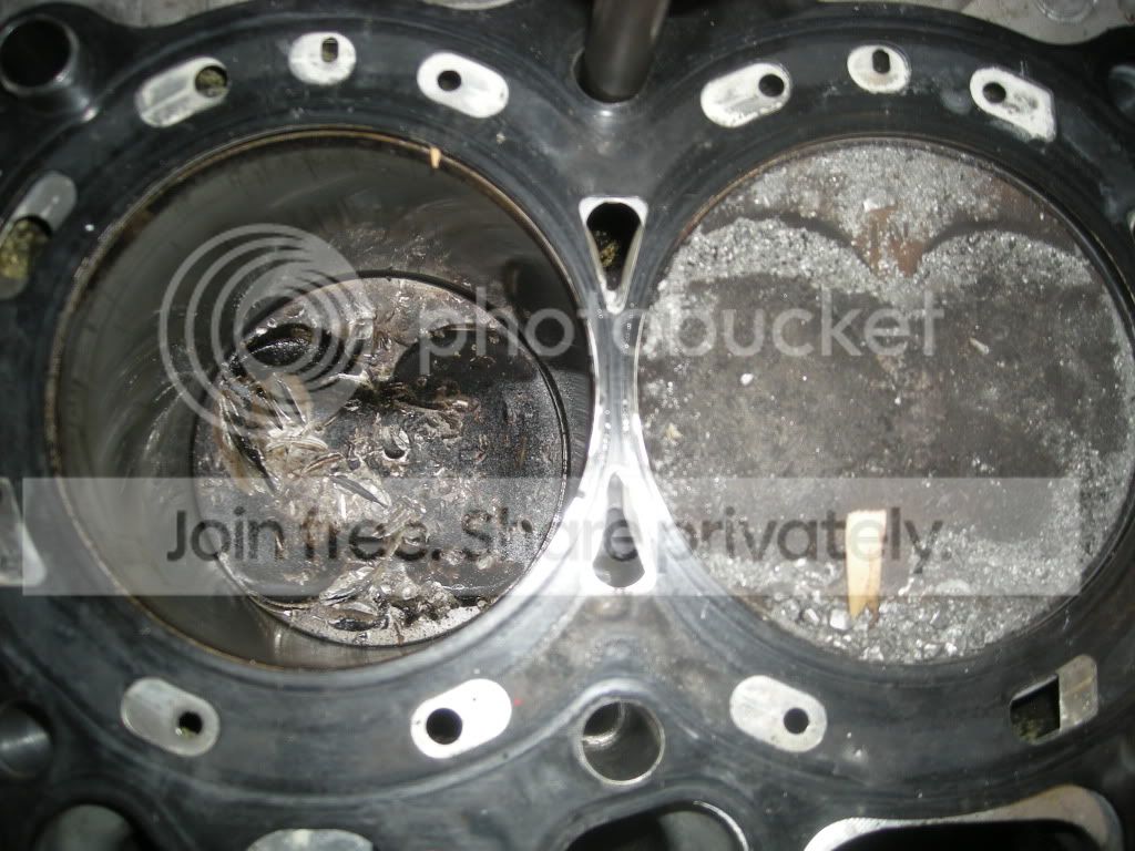

Engine Destruction:
Removed Head:

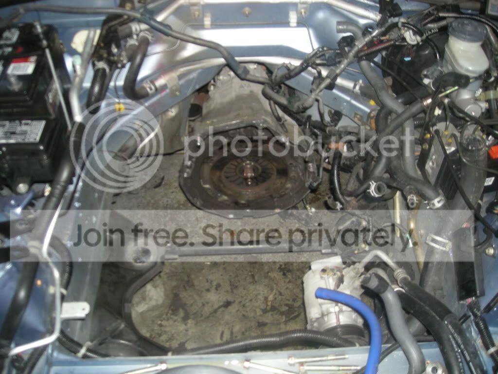

Removed Engine:
