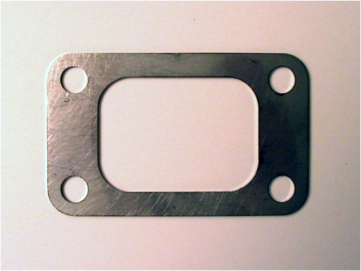

In the Mitsu world we just get a good gasket...Im sure you can find a nice thick stainless gasket like this Street Tuned Motorsports.com - Rochester NY
