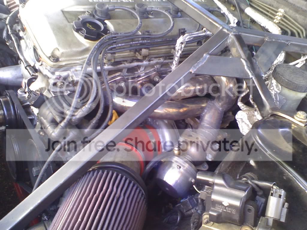

Originally Posted by JR
Clean welds. What is the thickness of the metal? You keep the that finish. Looks professional.
It's sch40 pipe els, I think it is 3/16 wall thickness. Its very beefy and weighs about 30lb

Originally Posted by turbofabworks
???What???!
Name one performance advantage of top mount?
Yah don't think too hard.. Its done for looks, and is slightly detrimental to performance.
try fitting anything bigger then a t28 on a bottom mount and retain a/c and p/s
A reasonably sized turbo could be fit on the bottom. Its done for looks.

i have to go topmount on my datsun, theres no room for a bottom mount
You can use longer runners on a top mount and still get proper oil flow on you return. try making a gt47 bottom mount manifold and see were your return hose is going to be.
Slightly detremental to performance? Where the hell did you pull that from? Do you suddenly know of clans of people running bottom mount GT30R's and raping top mount setups?
It's all packaging. Show me an elegant bottom mount T3 setup that keeps at least PS. I will not except some shitty log-type manifold just to prove your point. And....go!
