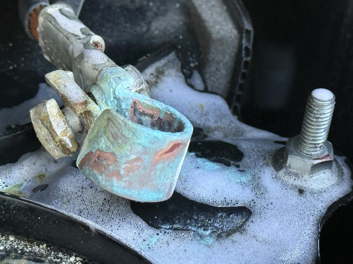

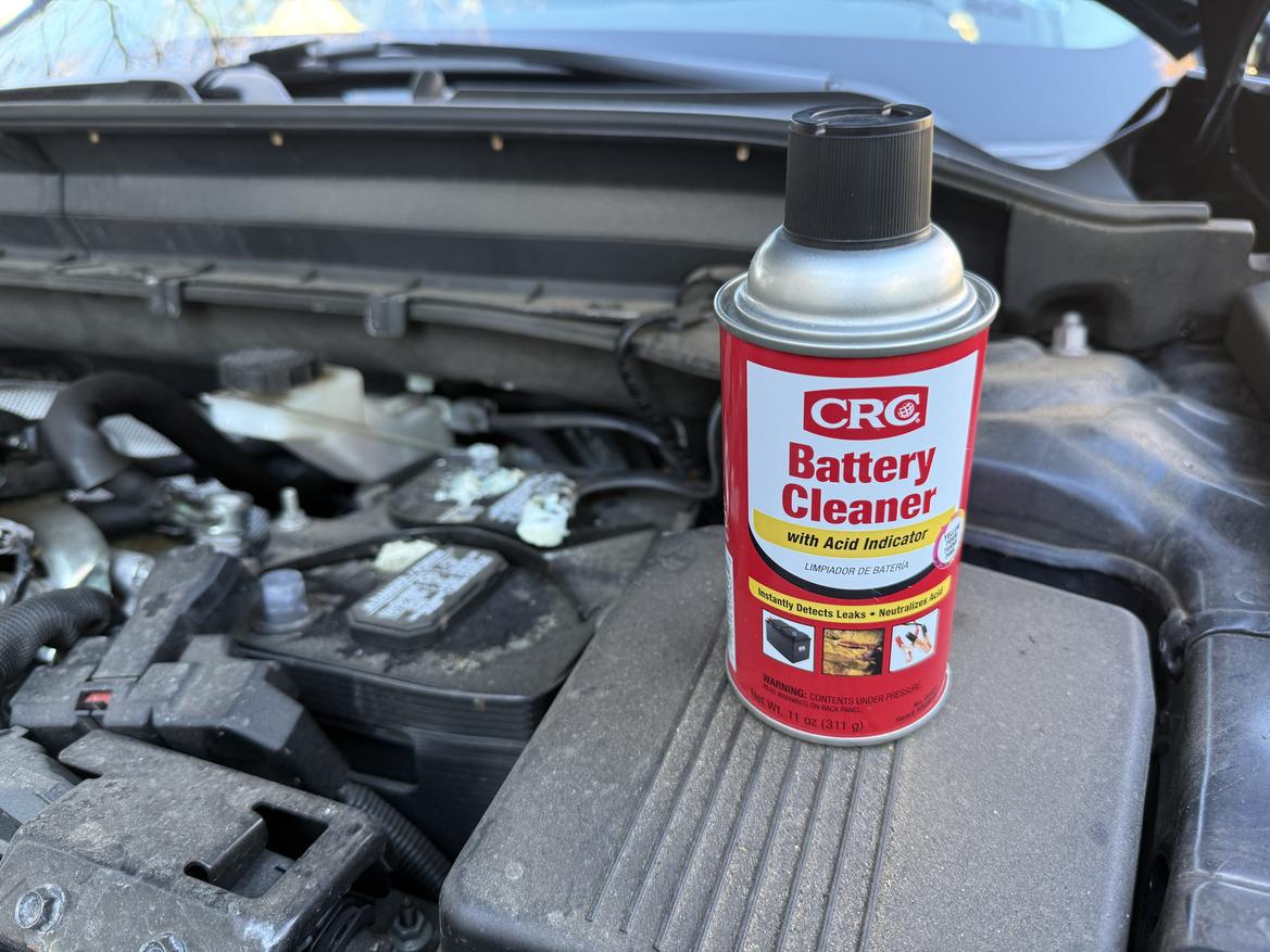

Now that you’re prepared, start by unbolting the cable from the negative terminal of the battery and then the positive one. With the cables detached, clean the cable ends and terminals with either a mixture of baking soda and water (a couple of tablespoons of the baking soda per a cup of water) or a battery cleaner like the one CRC offers. Both products help neutralize any battery acid present. The nice thing about the CRC Battery Cleaner is that it turns pink in the presence of acid.
Apply the baking soda mixture with an old toothbrush or simply spray the battery cleaner on the terminals and connections. Let the cleaning product sit for a few minutes and then scrub away with a toothbrush or a nylon wire brush. Repeat as necessary.

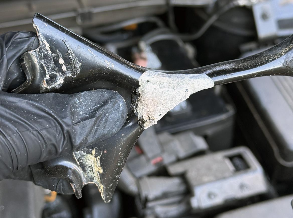

Don’t forget to clean the battery’s exterior and its hold-down with a cloth–we prefer a microfiber one since it better traps all the corrosion bits. We removed the hold-down to the battery in our example and it had buildup underneath it. There we found the root cause: Someone overtightened the hold-down and cracked the top of the battery.
After all this scrubbing, things should look a bit better. Rinse off all the washed areas with water (we prefer distilled, if possible), wipe them down and let them dry. After that, use either felt washers (available from your parts store) or a product like CRC Battery Terminal Protector. Both inhibit corrosion buildup. CRC’s product sprays on with a red film. In time, that red film turns clear, which means it’s time for another cleaning.
