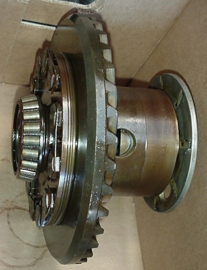

Here is the pumkin

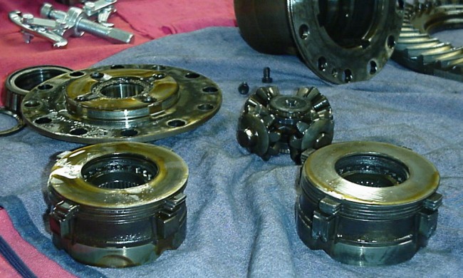

And here are the greasy grimy guts

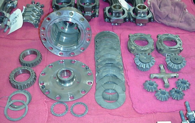

And here is everything all nice and clean. Its great having access to an industrial parts cleaner.

Here is the pumkin
