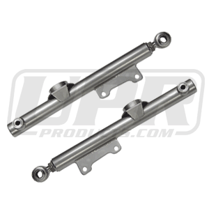

This may sound like a dumb question....but do those relocation brackets have any weld on them?
Those are some SSM bars that someone done some custom fab work on. They cut them, plated the end, added a nut and a threaded rod end on them, probably when the bushings wore out on them

Are the relocation brackets welded? Doesnt look like it
Luckily they are bolted on
But theres only one bolt...they would be moving around like crazy! Supposed to be welded

The tq arm was holding everything together...now that its removed, these have to be welded
Actually the bracket bolts to the lower shock mount and also has the bolt going through the housing
The tq arm was independent of this as it was bolted to the axle
