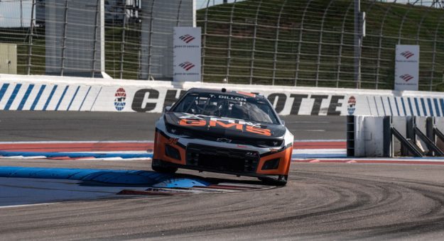

NASCAR heads back to the Circuit of The Americas this weekend and the anticipation is high as the NASCAR Next Gen car makes its road-course debut after starting the season on a variety of ovals. This will be a big test for the new Cup car as teams will look to take advantage of some of the new features, such as the independent rear suspensions and increased braking capacity that make it more compatible with courses where they will turn both left and right.
While the cars will have drastically different suspension setups from what we’ve seen over the last few weeks, the base cars will not be based on unique chassis as we’ve seen in the past and instead will have different pieces bolted onto the same suspension uprights that teams have used on the ovals this year.
