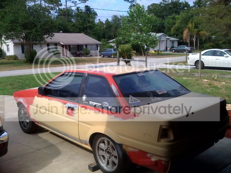

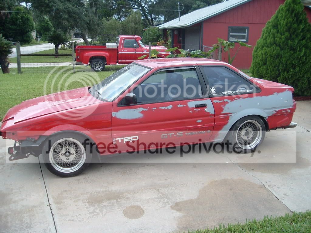

so yeah, i've had this car for alomst 10 years and haven't really done anything to it. well it has springs/ shocks, and some minor brake upgrades, but thats about it. plans are for a really clean/show/weekend driver, maybe a track day or 2 (grip only).

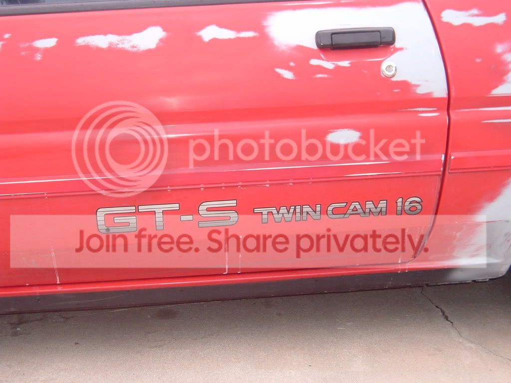

real jdm gtv stickers for the doors. (they don't make the usdm gt-s stickers and this is all i could find that was a real toyota part.

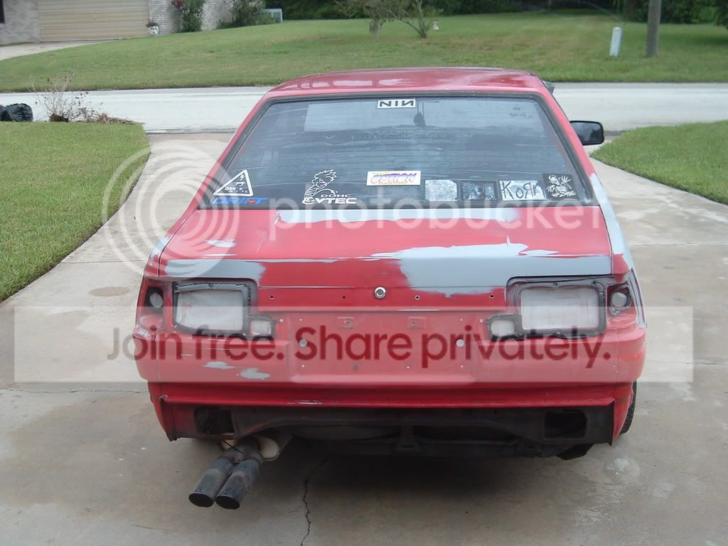

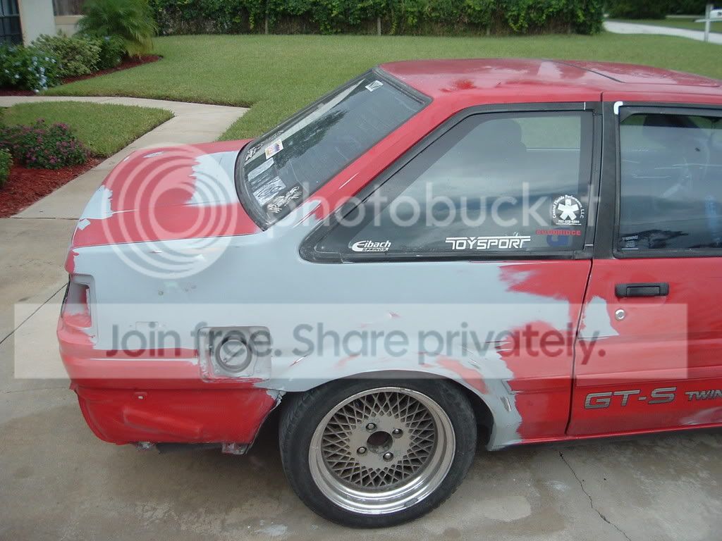

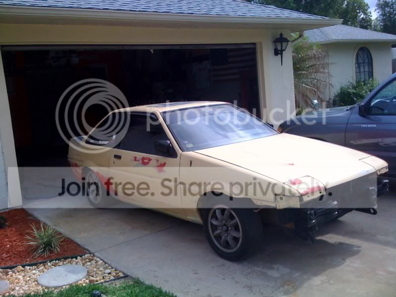

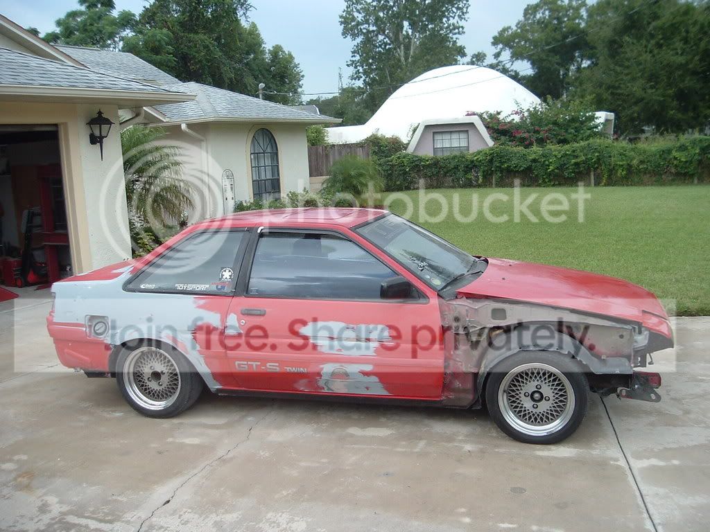

here are some pics of how the car was before i started on it:

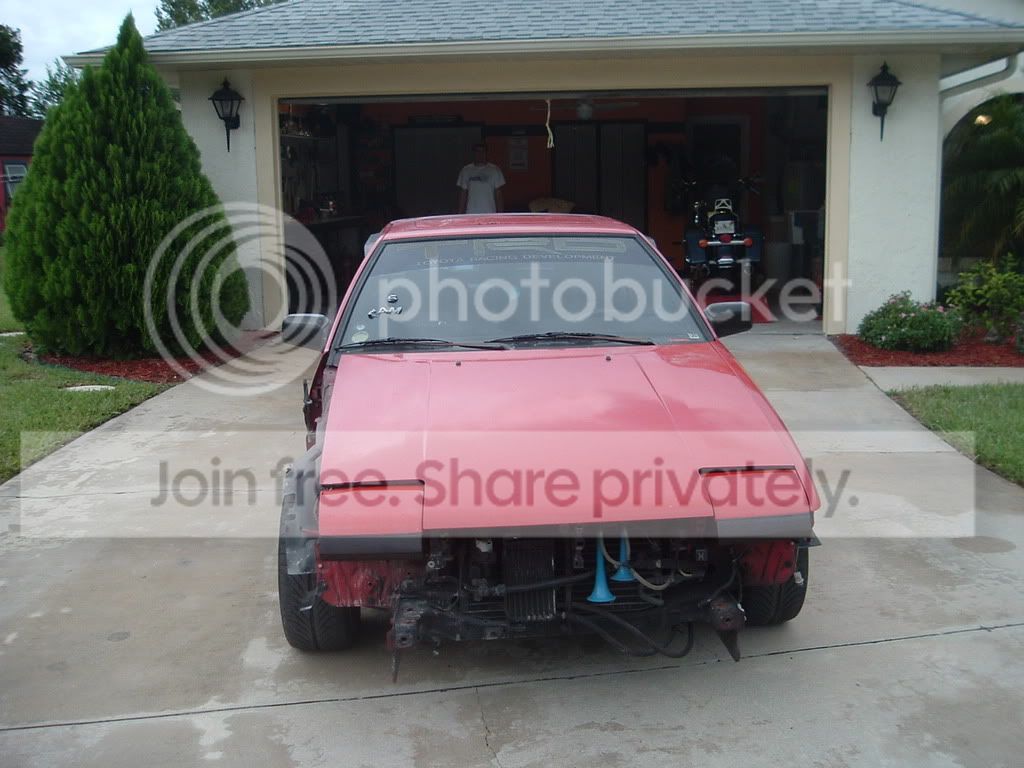

just some updates. pulled the motor and everything out of the engien bay for paint. and started reassembling a high comp blue top i had built along time ago and never finished.

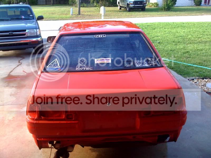

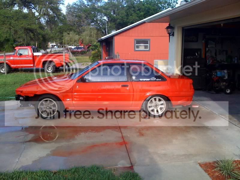

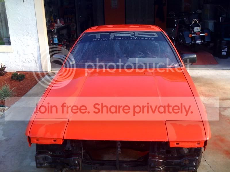

small update, the cars all one color again. the engine bay is done so i can take the car to my dads shop so i can put the motor in it and get it running. this is just a base coat in red. the final color will be mazdaspeed miata velocity red. once the car is done and running i can drive it to a booth and finish painting it.
