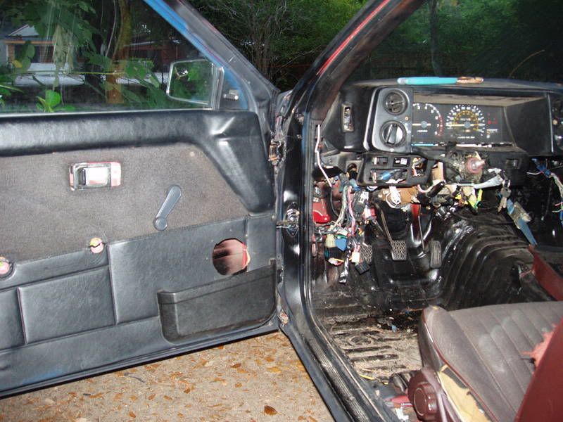

so i got to hear and feel the vvt hit today....it was sweet....ok pics not the cleanest at the moment but ive been more working on getting it all working right.

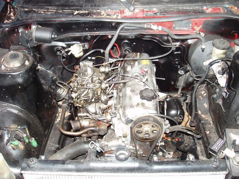

this was the motor when i got the car

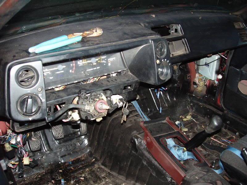

this was the interior when i got it home

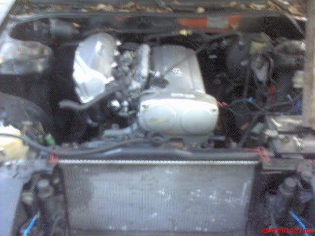

the initial 20v test fit

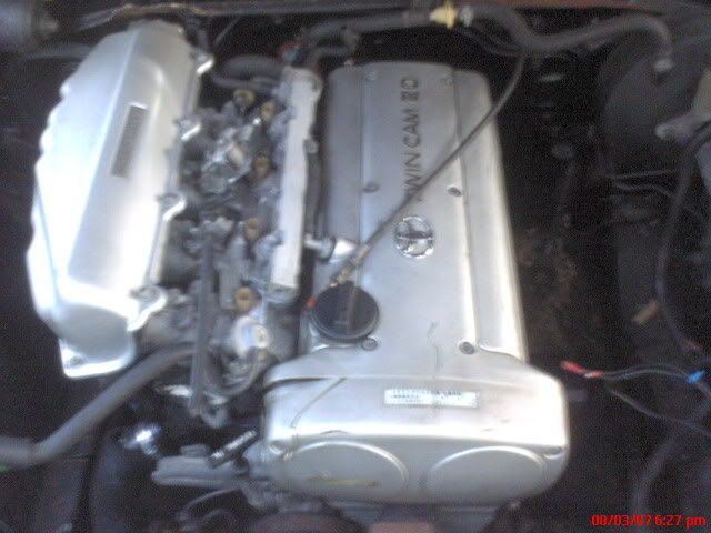

middle of 20v install

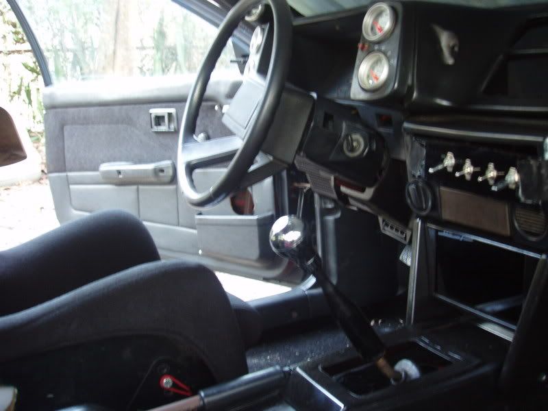

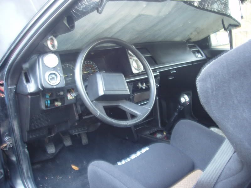

new interior pics

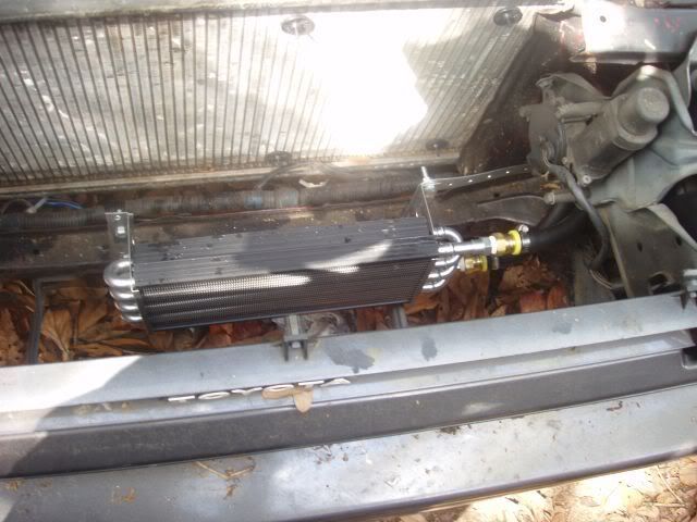

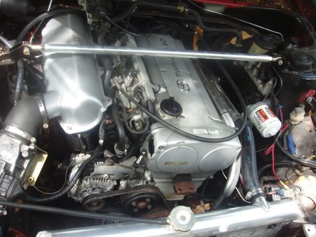

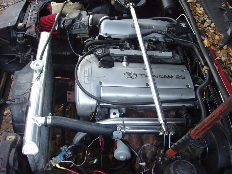

motor pretty much done and oil cooler/filter relocation
parts that came in and are now installed

looks great! what ecu are you using? did you cut the firewall?

thank you ....yea i did cut the firewall,(easy access to dizzy, water lines, sensors ect) and im running all stock silvertop electronics/ecu
