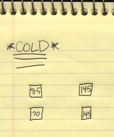

Old Jul 3, 2009 | 08:57 AM
jblaine's Avatar
Comprehensive
Posts: 776
Thumbs down
"If the deal's too good to be true, it probably isn't true."
6 months ago : "Sweet, these heads look redone and they're already attached. The valve lash is within spec too."
Fast-forward to today, after 6 months of very detailed re-assembly and care while preparing this car for resell, and $2300 additional spent.
Well...
It idled fine once I fixed the IAC. Zero CELs. Purrs like a kitten.
Drove it around the block a few times, fine. Continued around larger blocks which incorporated streets where I could get on the gas a little. After a few half-throttle pulls which felt pretty weak or so, CEL comes on. Misfires.
Reset ECU
Perform same test. Feels weak. CEL. Misfires.
Pull car back in.
Compression test today:

aww nutz man..
