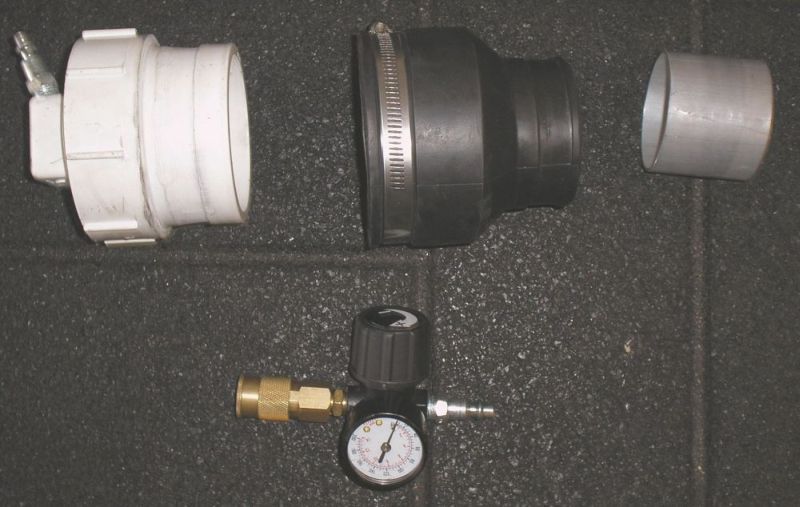

I followed some simple instructions that SS gave me and made one of these devices. The parts can all be purchases from Lowe's and this should most definitely be done prior to any tuning.
Here is SS's thread that outlines all the parts. I happened to have that Samco hose laying in my garage so I used that.
Anyone have some good info on pressure testing? - IWSTI.com
Pleae note in this pic I was just test fitting and you wouldn't want to fill the intate system with 20psi without a clamp holding the tester in place

Here's scotts:

What part of Lowes is that air gauge in?
Probably the same area that has the air compressors and air tools.
Old Dec 15, 2006 | 09:19 AM
41ants's Avatar
Joined: Apr 2006
Posts: 249
That's exactly right. I purchased a kit for the fittings and the regulator and gauge came in a kit as well.
Old Dec 15, 2006 | 05:58 PM
I'm Slow's Avatar
I'm Slow
Posts: 10,608
part #'s and PVC and hose sizes would help this thread a lot
