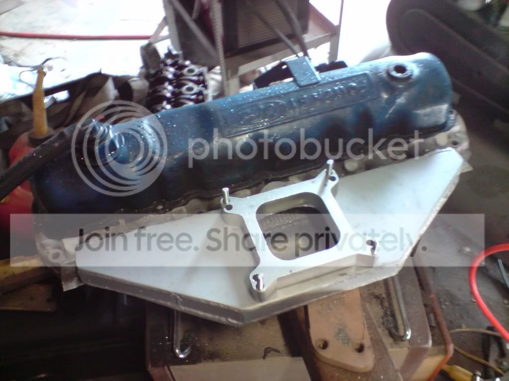

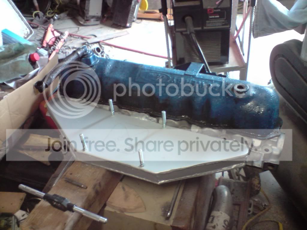

After getting the motor I started with the crappy log head. I started off by doing a pretty modest port job on one of my extra heads. I cut off the log and welded up a plenum to weld to the head. Heres where I am now, just finished it up this morning.
still need to cut the hole for the carb and figure out how I want to mount the carb to it. I guess I am going to need a carb too....
I made a CAD file for an exhaust flange so I can weld up a tubular manifold. still not sure what turbo(s) I will run. I have an IHI, but need another one for twins, or may run a different unit.

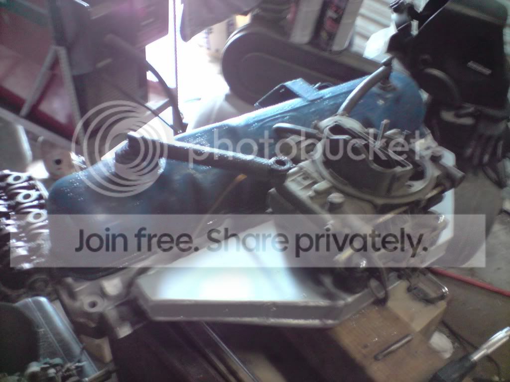

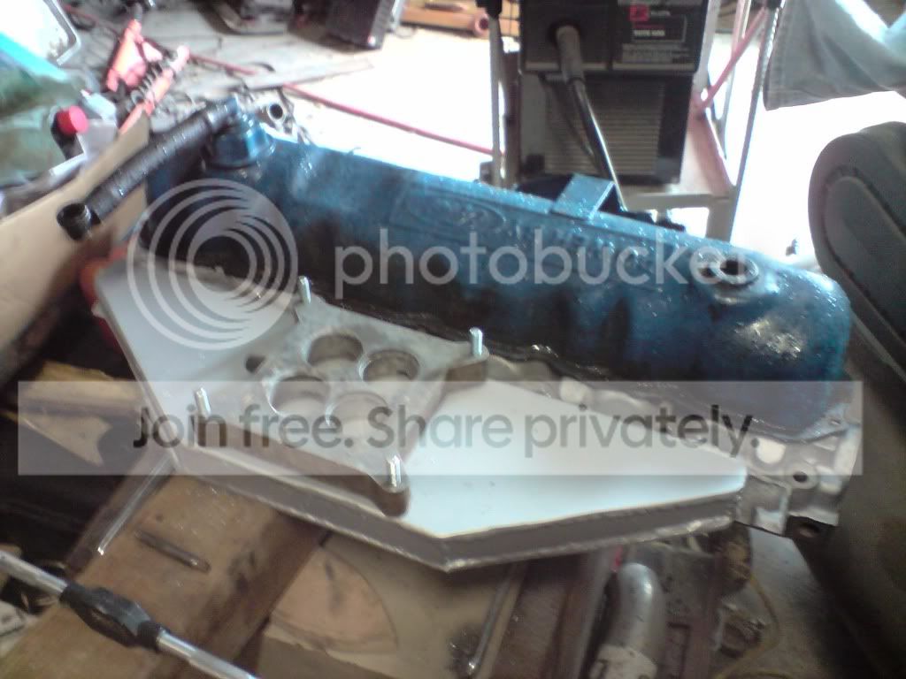

Cut out the hole and drilled and tapped the intake for the mounting studs. Picked up a spacer at work to make some room for the linkage and the valve cover. This is a carb I had laying around not the one I will be using but looks like everything fits good. Definitely fills out the manifold better than I thought it would. Almost makes it look like it could be fast one day.
Again sorry for the crappy pics.

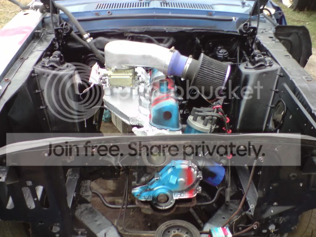

Old Mar 11, 2010 | 05:45 AM
hasa68mustang's Avatar
Posts: 178

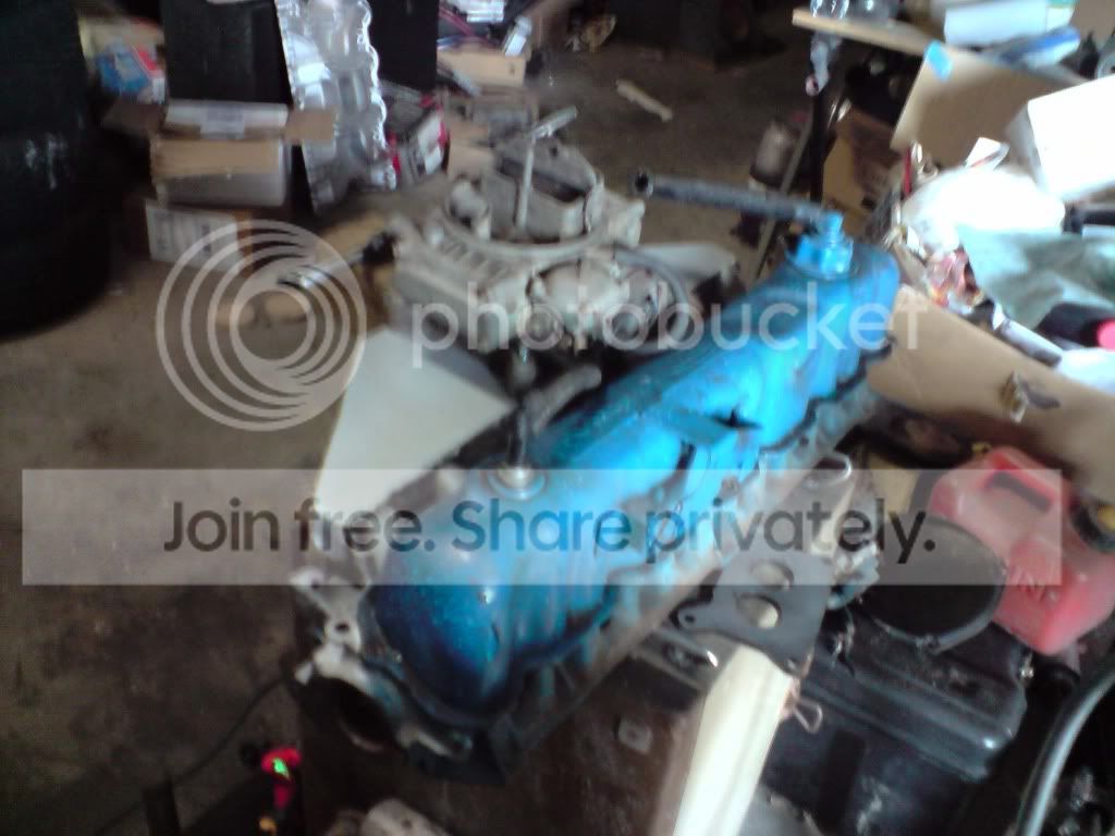

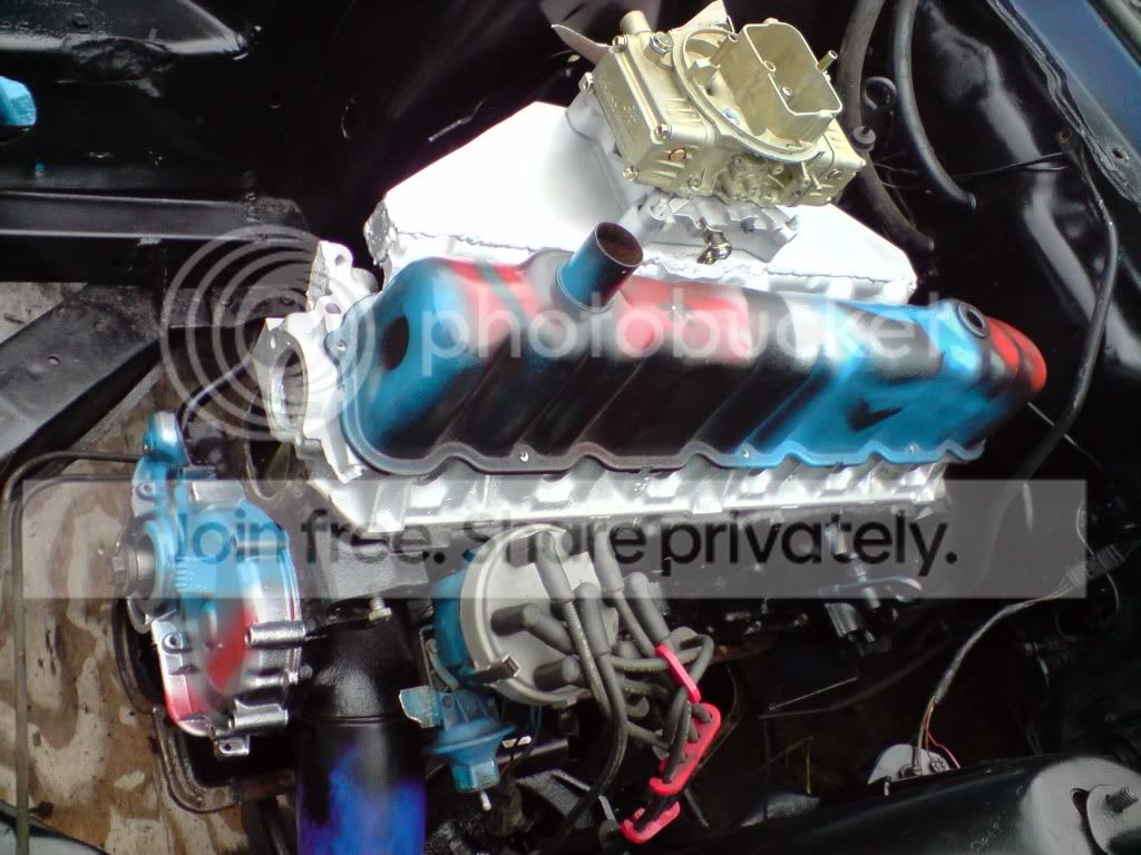

Finally got around to doing a little more work. One of my friends came over when I was getting ready to roll the welder out and start filling all the holes and junk, and talked me out of it because he knew I would get way too into it and never finish it and it would be a few MORE months until I got the motor in. So we did some sanding, shot it with some semi gloss paint, and threw the motor in. I pulled the timing cover off and found a TON of slack, almost enough where I could make it jump teeth It ground a pretty good amount out of the timing cover. I had a spare so I threw some paint on it, and picked up a new water pump and timing chain from work. Didn't know what color to paint the accessories so I decided a little bit of of every color would be different. I like it.
I just threw the carb hat on with the filter for fun. thats it for now, its warming up so I can do work again... lol I HATE cold weather
