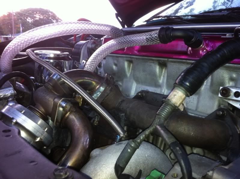

here is a pic of the car when I got it, it was making 248whp and 268lbs of torque the car was not popping vtec and the turbo was blown it was only boosting 8psi's. 248 is extremely low especially when the car was making 207whp n/a when it was completely stock. So i decided to up the boost and retuned, here's what happened.

Since then alot has change the turbo finally when out and so did most of the bottom end the car is really low on compression on cylinder 3 it has only 135psi's and the rest have a perfect 210 and I installed a breather kit and you can see that it has an ass load of blow by so a rebuild is a must if I want 800whp.

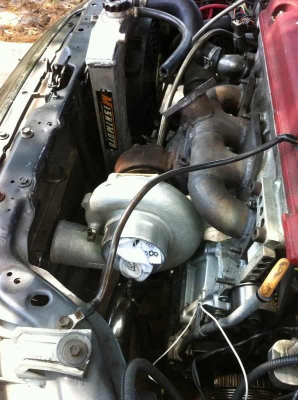

My new turbo this thing is huge I never Imagined how big it was.........
precision 6765

New turbo manifold, twin disc clutch, 1600CC injectors, size 10 an fuel lines, 340 lph fuel pump feeding a bosch 044, and AEM ems with k series coils fuck the hondata s300 its time to upgrade.
