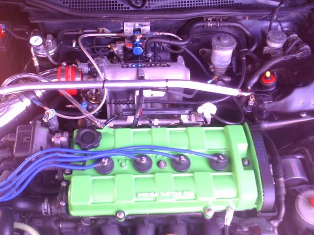

painting valve cover
thanks guys but i got it and its turning out pretty good, and David i gotchu mayne, imma guy like 2 quarts of oil and some latex paint tomorow thanks for the help....... SIKE.
