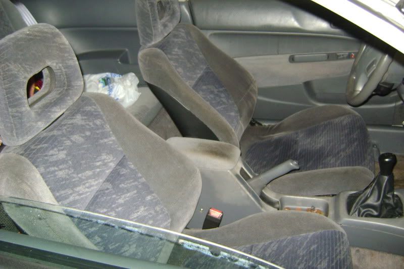

Traded my stock uncomfortable seats to a great friend of mine, DriveMod03 for some Teg seats.....i love them!

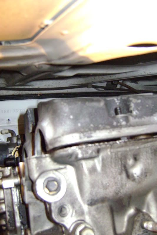

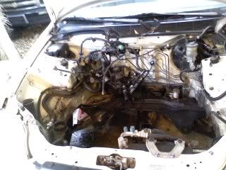

Once the motor was out.....the cleaning and modifications began...
i used an old long block too mock the engine bay for the mounts.
The CB7 bracket doesnt fit at all. HAd too buy a new bb4 bracket from Innovative i think.
Hood clearance was better than expected

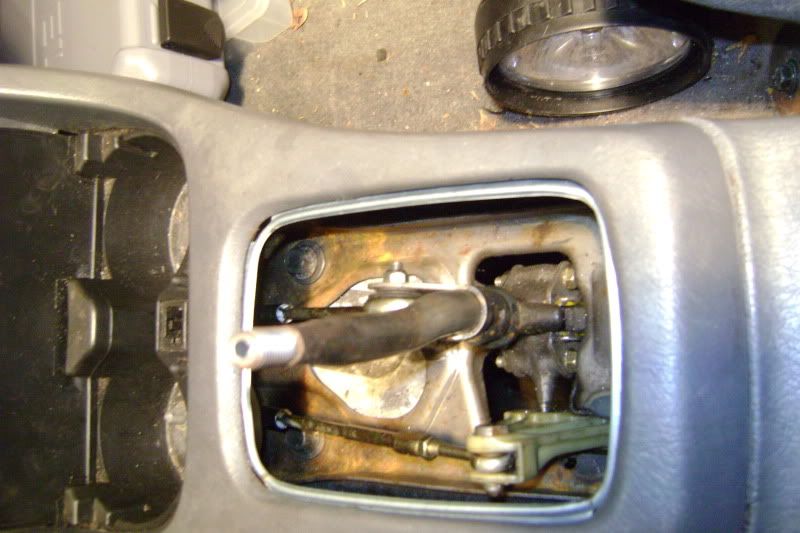

Then came installation of the shifter assembly. I LOVE MY DREMEL!!!!!
took hours making everything fit perfect.
sits perfect

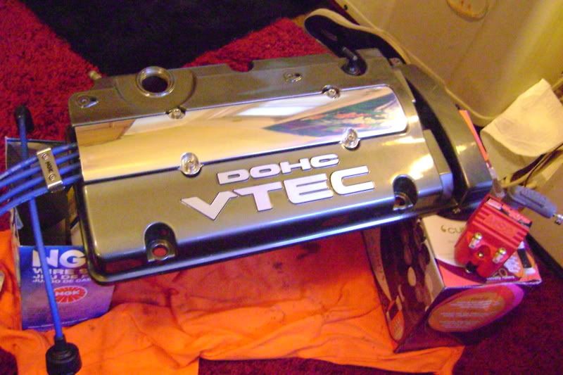

I did work some overtime too pay for some goodies. PWJDM vtec solenoid cover, battery tie down, CTR shift boot
MSD coil, NGK wires, Inline4 billet plug cover, black chrome valve cover. which is being replaced for the 3rd time.

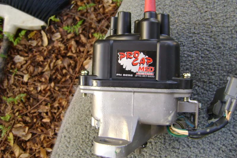

New distributor with msd cap and rotor.

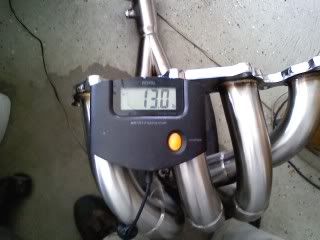

Saving weight is my main goal for this project. hints why i did this. The pink shit is for my ex's build. i just used them for weight records. im not using a lot of this. i still have too weigh my jdm exhaust, intake, and new ac bracket i think.
stock h22 flywheel (not JDM)
my old act streetlite
my new act prolite
balance shafts
f or h ps bracket (not using. but recorded anyways)
f/h front mount bracket
f/h ac bracket
f/h alt bracket
im installing the kazinspeed eliminator kit as well. all balance shaft shit will be weighed as well.
weighed my kiddracing header. Poor quality. Flange is warped 20 thousandths. expected it. ill fix it though.

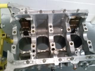

Finally i was able too really start on the motor.
Honing
all done
