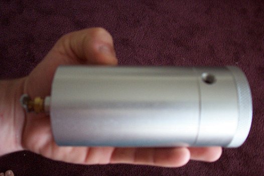

Heres the size of it.

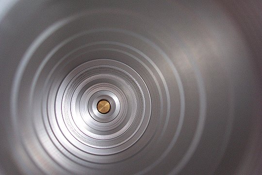

Joined: Jun 2000
Posts: 5,694

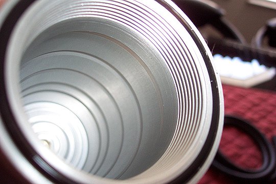

Here are the undercuts to keep oil from climbing the walls of the can.

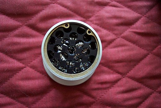

Another shot of the inside..
