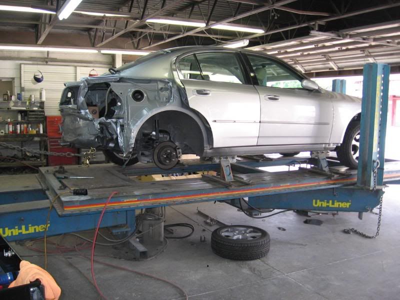

it all depends on the amount of damage etc, average body shop labor is 42.00 /hr and off the top of my head a car with damage similar to yours, of course im making some assumptions here is about 20-30 hours give or take of course. This is an example of what u have to do to properly pull a car with frame damage.
