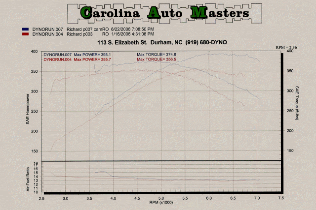

Ok, so, i've gotta get around to assembling one of my transmissions soon, and trying to decide which to use, i've got two, one from a corvette MM6, the other a GTO box with the MN12 gearing, tire size will be a 255/40-17 ultimately for daily use rear, as for the rear gear ratios, i've currently got the early Q45 center section in, with its 3.54 gearing, but of course it would be pretty easy to grab a J30 R&P and install in another Q45 housing, giving me the 3.91 J30 ratio, and I have also been looking to pickup a newer Q45 3.69 center also.

Here is a dyno graph of a LS2 GTO with the same cam i'll be running, which should help a little, this should be about the same as what i'll put down. The blue lines

tuner1989's Avatar
Posts: 1,412
Was there anything else done to that gto besides A CAM.

Probably has shorty headers or similar construction stockers.

My bet is probably typical bolton setup, longtube headers, catback exhaust, air intake setup. Maybe a slightly bigger throttle body, probably not.
That is a fairly tame cam though, I was looking to go a little bigger, but really dont want a rough idle, a good bit more power can be made with stock heads and a bigger cam, but at the expense of the idle for the most part, honestly with that kind of power curve it should be awesome on the street, probably run mid-high 11's at the drag strip, and with a 150 shot put me into the 10's with very little trouble, all while maintaining great driveability and fuel mileage.

The post where I found it was 2006 though, and no other info was given, generally a lot of setups now are making a bit better power with similar cam specs, 224-228 or so duration usually putting down something like 410-420 RWHP with full exhaust, air intake and an underdrive pulley.
