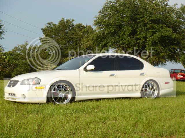

Just a quick note that there are 02, and up, maxima's running really low 12's on little more than a shot,some exhaust, and slicks. Mids 12's on stock OEM tires. With all else being stock. This is a great VIP style platform and you will be greatly pleased by how versital this car can be.
go for VIP!
