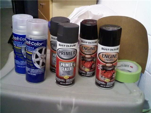

Materials:
120 & 220 Grit Sandpaper
Toilet Bowl Scrubber
Tooth Brush
Primer
Paint
Clearcoat
Masking Tape
Soap
TIME AND PATIENCE

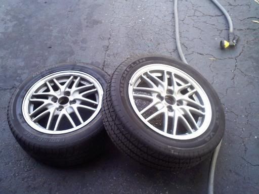

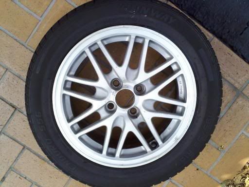

Step One:
Clean the wheels!

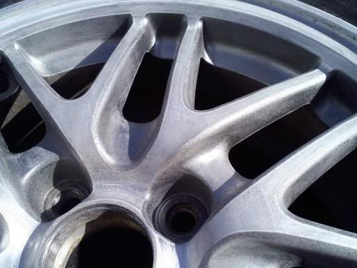

Step Two:

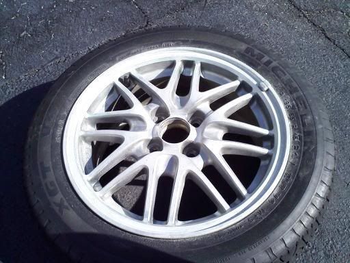

Let them dry all the way and dry sand

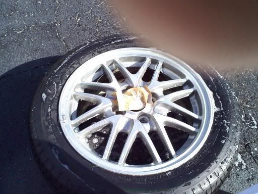

Step Three:

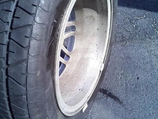

Clean them AGAIN! And Start wet sanding... Use LOTS of water!
( Excuse my finger )
Step Four:
Wash them AGAIN! And let them fully dry and make sure there is no residue or dirt or anything on them.

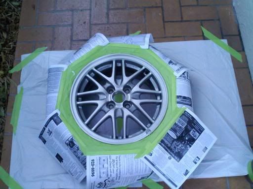

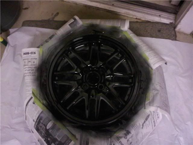

Step Five:
Tape off the tire.

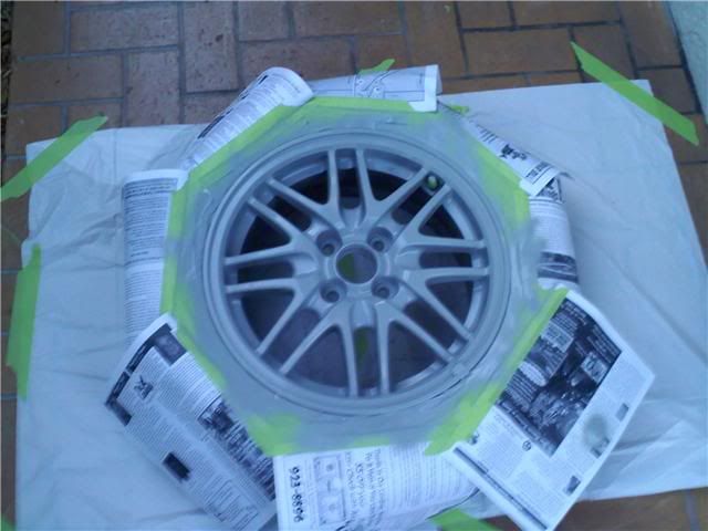

Step Six:
Time for primer. Take your time and spray LIGHT and even coats. It took me 3 coats of primer to fully cover the rim... Take a 5 minute break in between coats of primer
Step Seven:
After the 3 coats of primer wait 10 minutes then start on your first coat of black... Again, Spray light even coats and take your time and DONT over coat the rim because it will run and not look good! So take as many coats as you want until they are fully covered... It took me like 4 coats of black.
After you are done with all your coats and your rim is fully covered in the color you want wait 30 minutes to make sure they are dry and time for clear coat!
Wait 10 minutes in between coats of the clear and use 2 medium coats because thats what protects it and gives it that nice shine!

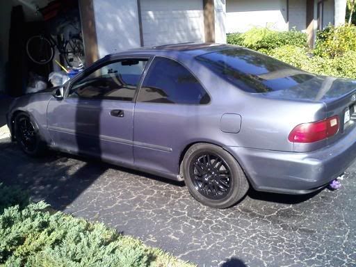

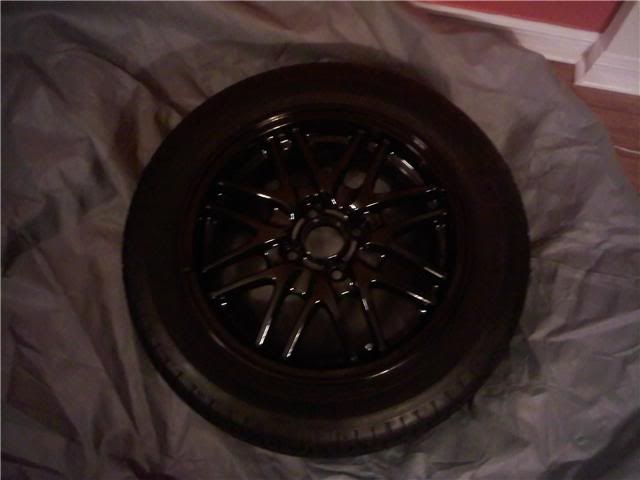

So after that take off your tape and let dry over night to make sure they are completely dry! And here is your final result...

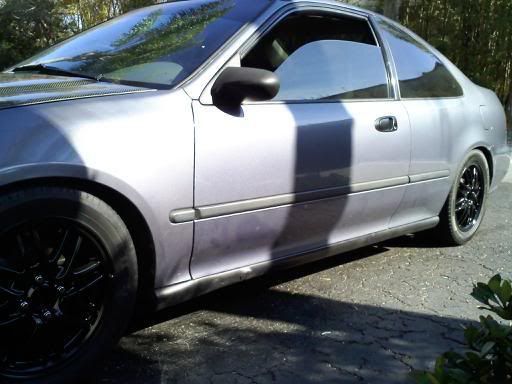

Here are the rims on my car... I will get better pics once i wash the car
