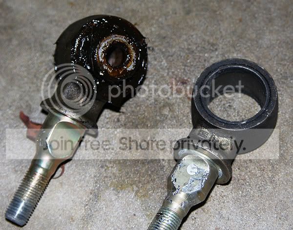

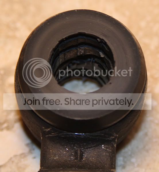

we used a torch to burn out the old rubber bushings (torch can be purchased at home depot for around $15)- you just hold the flame on the bushing (in a well ventilated area). the rubber will pop out or heat up enough to be pulled out with channel locks.
before and after.

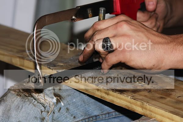

after burning out the rubber bushing there will still be a metal ring inside which needs to be removed to fit the poly bushing in. you can get a hack saw, put the blade inside the hole where the rubber bushing was and cut a line through it. then take a hammer and a flat head screw driver to knock it out.

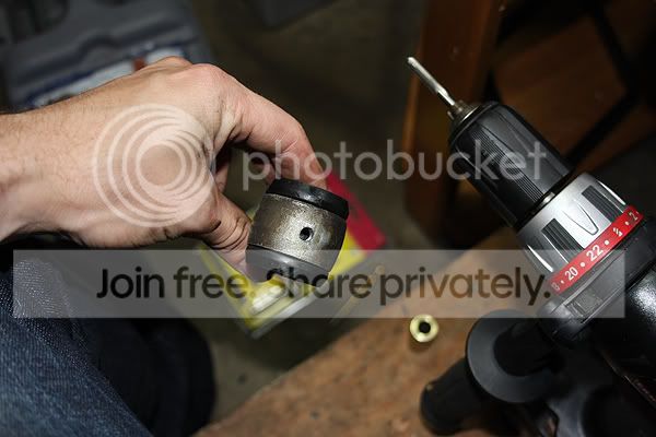

you can get the grease fittings from an autopart store. get a metal drill bit and a threading kit that matches the threads on the grease fittings. drill a hole in a central location somewhere on the piece where it will clear the UCA (for the prelude i found that directly on the bottom was the best place (you also want to be able to access the grease fitting by just removing the rim) allowing you to grease the poly bushings regularly and with ease. you want to have the poly bushing in place so the hole is drilled through it also.

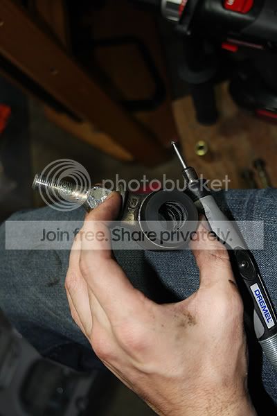

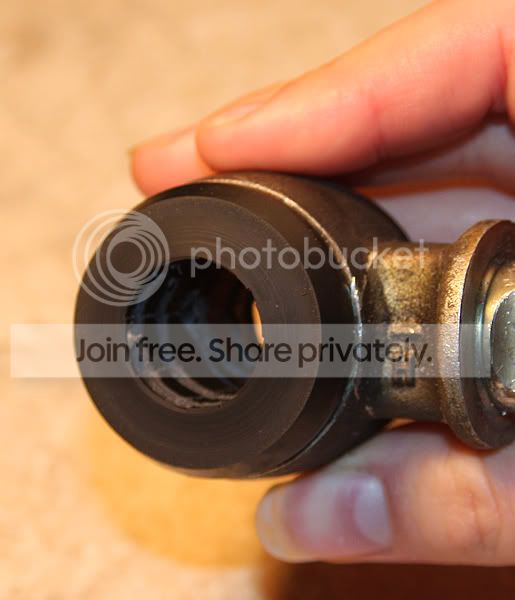

after threading the hole you made use a small dremel bit to carve a spiral path on the inside of the poly bushing starting at the center where the whole is and spiraling to almost to the edge of the bushing. repeat this on both sides of the bushing.

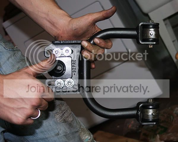

slide the metal sleeve into place and screw the grease fitting in (i suggest using thread lock).

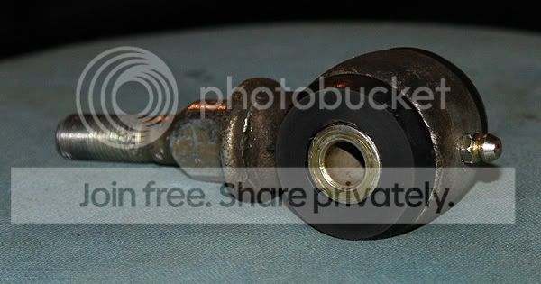

then install the bushings onto the UCAs (Chassis Tech adjustable UCAs used in picture). connect a grease gun to the grease fitting and inject the grease. you will know when it is enough. i am using a green grease from the auto parts store.
thats all she wrote folks! install your UCAs and the job is done. this can also be used for almost all other poly bushing applications.
