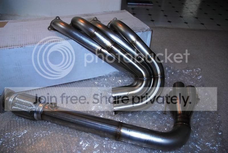

But idk. I'm mostly talking out of my ass. I'm no expert at anything, just trying to plan out a good build/header. My design would be something like this one (first pic), but I'm thinking about doing doing something more radicical like in the second pic (although with longer primaries)... Third picture is a Bisi header for a D16, fourth is a Bisi header for a F22 (both Bisi headers are Honda engines).
Hondanickx's Custom D16 header from OneCamOnly:
Random Race Header Remoer on OneCamOnly Found:
Bisimoto Version 2 Header for D15/D16's:
Bisimoto F20 Header (on BigMike's Prelude):
