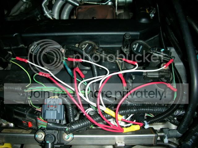

MSD - won't work at all. I mean I'm sure it does but 3 shops couldn't get it to work previously.
Auto Meter - requires you to tap into each coil positive and ground, not wanting to go through all that.

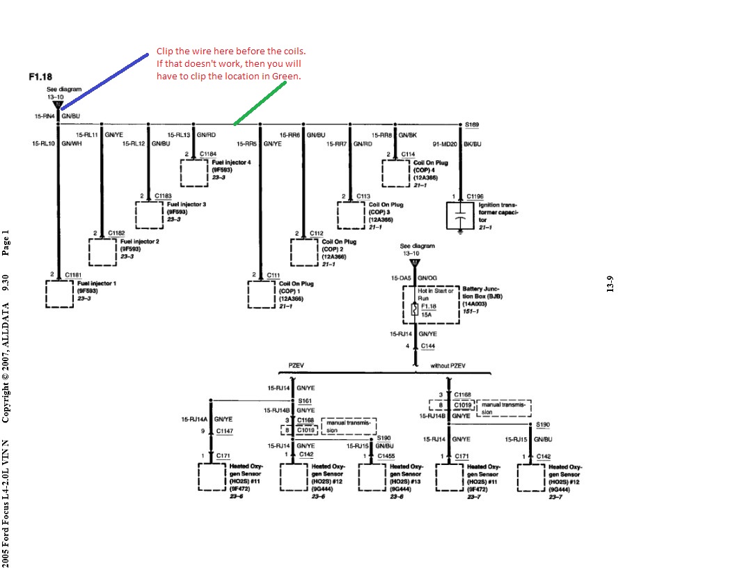

05 focus
Old Oct 21, 2011 | 11:43 PM
EsCoRtLvR's Avatar
Escort Connoisseur
Joined: Jun 2003
Posts: 2,574
You need an Auto Meter 9117 Tach adapter.
It feeds off the common positive wire.
Instructions on Install here
http://www.jegs.com/InstallationInst...5/105-9117.pdf
Here's a video of an install on a 99-04 Mustang with the Coil On Plug system like yours.
http://www.youtube.com/watch?v=05lFAKN9uy4
Wire you clip here I believe...

Yeah if you use the common wire you get an incorrect reading from everything I have been told..
