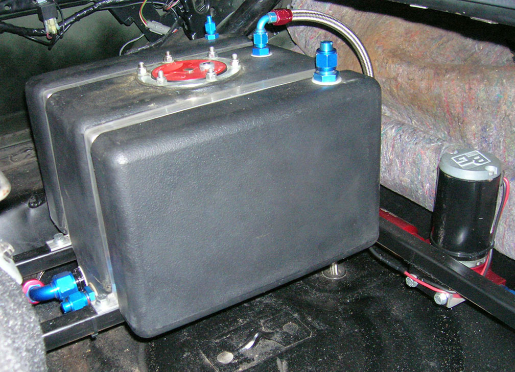

I finally had time to figure out how to post a picture.
I mounted the fuel cell and the fuel pump inside the trunk so there wasn't anything hanging under the car. If you look, you can see that the inlet for the fuel pump is still lower than the outlet of the fuel cell.

Yea, it is a little on the small side, only 5 gallons. Got it from Derek when he parted his car out. I understand you need a little more for a street car. What do you have? A 10 gallon?
