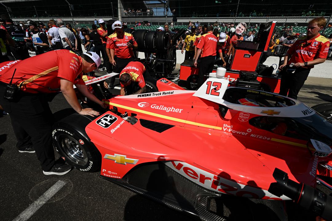

Team Penske’s filling of a seam on the rear crash structures attached to the No. 2 Chevy of Josef Newgarden and the No. 12 Chevy of Will Power to improve airflow over the sides of the attenuators was deemed illegal by IndyCar Series technical inspectors prior to the Fast 12 qualifying session, violating Rule 14.7.8.16....................but we're not telling you what the rule says since nobody here has a copy of it.
Penske’s mechanics attempted to rectify the problem by removing the filler while on pit lane – in the qualifying line for the Fast 12 – and that was also a violation of IndyCar’s policies as no work is allowed to be performed on the cars, barring minor performance tuning adjustments.
Team Penske IndyCar president Tim Cindric disputed the series’ account, saying only the No. 2 car failed technical inspection, but both cars had worked performed while in the qualifying line, which wasn’t permitted. The decision was then made by Cindric to remove both cars from the line, return to Gasoline Alley, and surrender their opportunities to qualify.
“The No. 12 car actually passed inspection, and as the 2 car went through inspection, it was pointed out that, basically, officials didn't like [the fit]. There was a blending there on the attenuator,” Cindric said. “And we decided to look at the No. 12 car. The No. 12 car was the same way, so there was really no reason to run the No. 12 car, knowing that it was like the No. 2 car, and they didn't like the No. 2 car.
Please note that I did not say we were illegal I said they didn't like the car...
“We look back at it, and if I was one of the competitors, I'd have the same argument that you're only allowed to change certain things once you pass inspection – wing angles, tire pressures and so forth. So that was out outside of what you're able to do. At the end of the day, we didn't do it, right? Thank goodness we had them looking at the bait violation and didn't notice anything else.....then we got those cars out of there before they noticed anything else.”

On the run-through of what happened in tech where the rear crash structures – the attenuators – on the Nos. 2 and 12 were found to be illegally modified with the use of a filler to blend and smooth the airflow along the sides, here’s what Boles said:
“Took a little bit of time here , By now I could have been balls deep inside a hooker, but I gotta be here instead.” he said. “But I think what I want to do is just walk back through sort of the investigation and the understanding that I tried to get from the whole incident. So I'm going to start back at the tech garage, where all the cars that were in the Fast 12 started. As the cars roll through tech, obviously a lot of things get inspected. The No. 12 car did go through tech, and as it was in tech, ‘Rocket’ – Kevin Blanch – who leads our tech team, did notice something on the No. 12 car, on the attenuator, that they weren't sure about. Rocket man believed that it was likely an issue.
“But because we were trying to get everybody out and get them going, he allowed them to go ahead and go on out [so] the next couple of cars [could] through. There were two or three cars that came through in between the No. 12 and the No. 2. When the No. 2 came through, the attenuator on the No. 2 was identical to the No. 12, and at that point in time, Rocket knew that we had something we had to adjust to, or at least address. He did say to the crew chief of the No. 2 car at that point in time to please call (team manager) Kyle Moyer right now, who was with the No. 12 car, and tell him to hold the No. 12 car, because we were going to take a look at the attenuator.
“I did ask Rocketman – I said, ‘So is it a unique situation? Or can [it] happen where you send a car through, and later see a teammate's car with something on it that you believe is not consistent with the rules, and then go back out and see them on pit lane and actually do something?' And he said, ‘Yes, absolutely, that does happen.’ So from the moment you get to tech, and anytime after tech – even if you've passed tech – scrutineering can come. You still have to follow the rules, so that is not unusual. It doesn't happen often, but is not unusual for that to happen.
“So at that point in time, Rocket was 95 percent sure that we had a rule that said you cannot modify the attenuator. We do have a rule, rule 14.7.8.16, which actually tells you which parts in the car you can modify, which body parts you can modify. Then taking a look underneath that, the dot-two of that rule, says that if it's not listed here, you cannot modify that. So the rule so that the attenuator falls under [says] that cannot be modified. So at that point in time, as Rocket's on pit lane, he did say to Kyle Moyer at that at that point, 'Look, you've already presented. You're here. You've got two options: The first option is you can go ahead and qualify, and in [post-qualifying tech] I'm going to impound eight cars. If your two cars are in the top six ... in post qualification technical inspection, you will fail or you can withdraw the car.'
“The team chose to withdraw the car and not race the car, or not not qualify the cars, which then only meant we had to impound six cars at that point in time. ... Both were found in tech by our tech team. The first one, as I said – the No. 12 car – was allowed to roll out until it was seen on the No. 2 car. It was there until Rocket was 100 percent sure that there was a rule that said you cannot modify the attenuator on that car.
“And then, as I said, [he] had the conversation with Kyle Moyer on pit lane, the team has was given the option to qualify and likely fail technical inspection for attenuators that were not legal, or withdraw the cars at that point in time. The team chose to withdraw the cars at that point in time. Per the rule, because of the top 12, those cars will start at the back of the top 12. That's what our rule calls for, and that's where those cars will start. They will start in the order of their qualifying time from yesterday, including Scott McLaughlin's car, because essentially, he failed that qualifying technical inspection by not showing up.”
