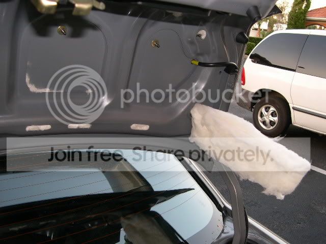

Okey i have sucksessfuly eliminated ALL the truck rattles. (now i have bumper rattles) lol, those will be next.
first off. this is what we have to work with

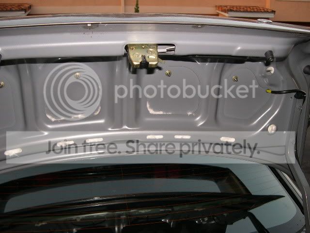

i removed the safty latch. if i ever do have someone in my trunck they are not getting out.
on to stage #1. i took about 60 sg feet of insulation. i bout a huge roll at home depo for about 10 bucks.
i took about 2-3 hours and i stuffed every oriffice

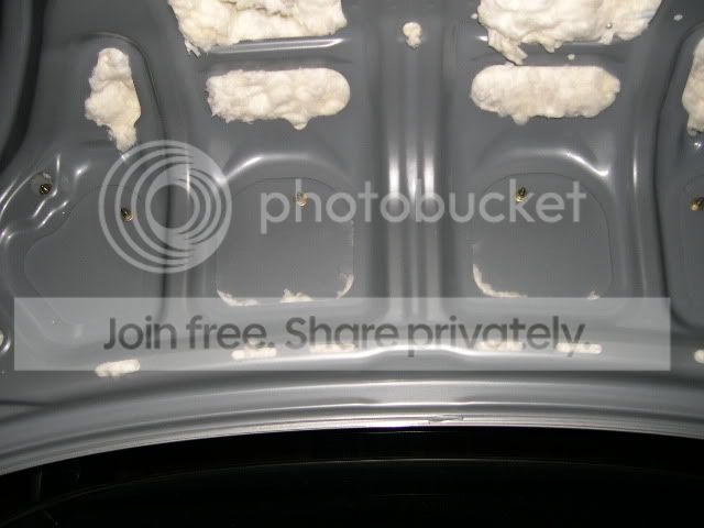

okey now that we have the whole trunk stuff`d like a huge turkey.
on to stage #2. but just with this i did notice a huge differance.

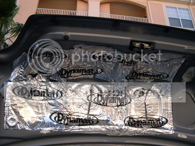

okey this is my attemt at doing something i have never done befor and it just seem`d like the right way to do it. i have put about 7-9 pounds of extra weight in the trunk lid. and i have no rattle in the trunk.
i also took the auto dimming mirrior/compas off and put on of the old school ones on. it makes a lot of noise.

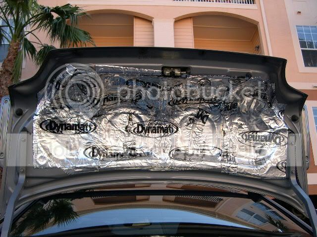

Stage #3 of this will be to cover the whole trunk with the same liner as my sub floor. to really make it look clean.

That has got to be the cleanest Dynamatting job on a lid evar. Are you planning on covering the dynamat with something else? maybe a cute lil STI trunk cover?
It never amazes me how much work people go through to stop other people from hearing their trunk rattle.
I'm taking a lsightly different path - I faced the sub into the vehicle and faced the three ports upwards with a false wall sealing off the rear from the front - 0 rattle and a lot louder bass.

yes i will be covering the dynamat with the same truck covering that was used for the false flooring.
